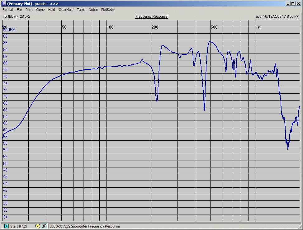

Given the measured response of a 728 here looks like the mfr’s curve if you add 20dB (for 10M distance)
http://www.prosoundshootout.com/Measurements/2006/JBL_SRX728 S_response.gif

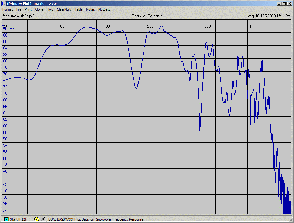

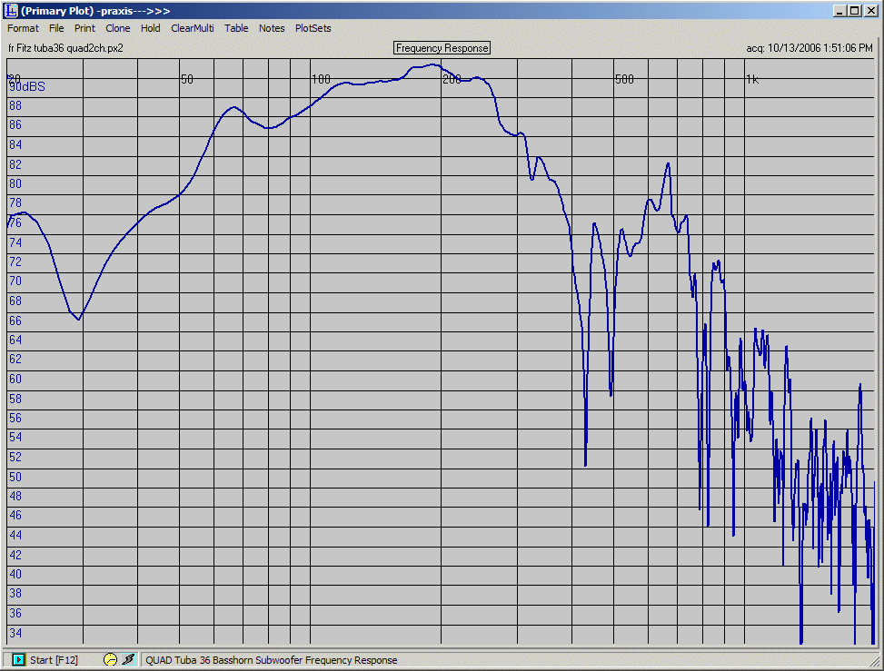

How do these horns look in comparison adding 20dB.
http://www.prosoundshootout.com/Measurements/2006/Tuba36_qua d.gif
http://www.prosoundshootout.com/Measurements/2006/12Pi_dual_ response.gif
http://www.prosoundshootout.com/Measurements/2006/BASSMAXX_T ripp_dual_response.gif
