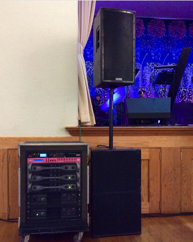

I have the KF300 for one of my rigs. However, my KF’s had pole mounts from factory. For this rig, I use the SB250 Subs and I ended up drilling out installing the top hat on both subs for the pole mounts, then place the speaker pole (metal gator works poles, don’t use plastic!) mount the KF and your good to go. This should get you the height you need and still being safe.
I know I’ve some photos available somewhere of this setup, I’ll try and locate them.
K2 might work ok, I have QSC 4.0 powering mine with the UX3600 crossover and it sounds great.
Josh.
I found it. Here's my KF300 rig with SB600 subs.
Being a productive member of society and encouraging others to do the same.
