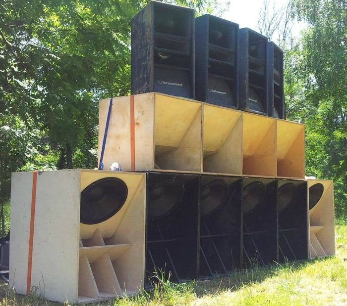

Last time we had a big techno name in the club we rented what you see in the picture (just withouth tops, we used our yamaha mid-hi boxes)
http://www.uesmag.com/wp-content/uploads/2014/10/boca_zvuk.jpg
These boxes were cut, hog scoops: 30-65hz, kickers 65-150hz i think with a slope of 24dB/octave.
Pushed them with MC2 amps.
With them i could reach some actual sub, not molded energy. Amazing transient response, fantasticaly fast drivers. I think some B&C 18's.
I don't remember when i heard something so defined and sharp. They also had more then enough power to do whatever i wanted with them. And to cause 40hz needle feedback from the vinyl players on stage :D
