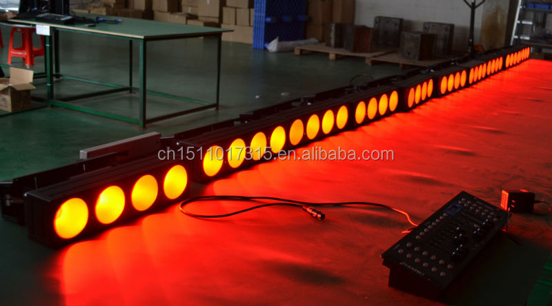

I want to replace the existing backwall a with a white background on which I use LED bars to give pastel shades.
As with anything you're going to have to spend a bit more to get halfway decent results. The 1/4w or 1/2w LED fixtures that you linked above produce some very poor color mixing at distances up to 24" from the fixture, this is clearly visible in the pic below where you can see the red green and blue hues near the fixture before the final color(purple) begins to take shape further up the wall.
A Tri/Quad/Penta LED fixture(each LED chip contains a RGB(red/green/blue) diode for example) such as the one below does a much better job at this although they too can still produce some noticable artifacts on some colors.. but it's only within about 6" of the fixture and after that the colors blend as expected. Fitting a diffuser lense reduces this some more and also widens the coverage a little.
The closest you will get to halogen through a color gel is something called an LED COB fixture, these are physically larger but produce better results because all the color mixing happens behind the fixtures lense. These can also have a much wider beam angle so you could potentially get by with fewer 1m bar fixtures or even a small number of single par cans.

Thanks,
This has helped me a lot. One Involite I looked at looks somewhat like the last picture you showed and I liked the color. Just the price was around 230euros a unit. If the angle is wider then that would be great.
I did order a Stairville to try it but it already on the way back to the store as the unit was damaged on arrival.
I think we might save some money and get better units. The quality of the light is important to us. not just its prescence.
